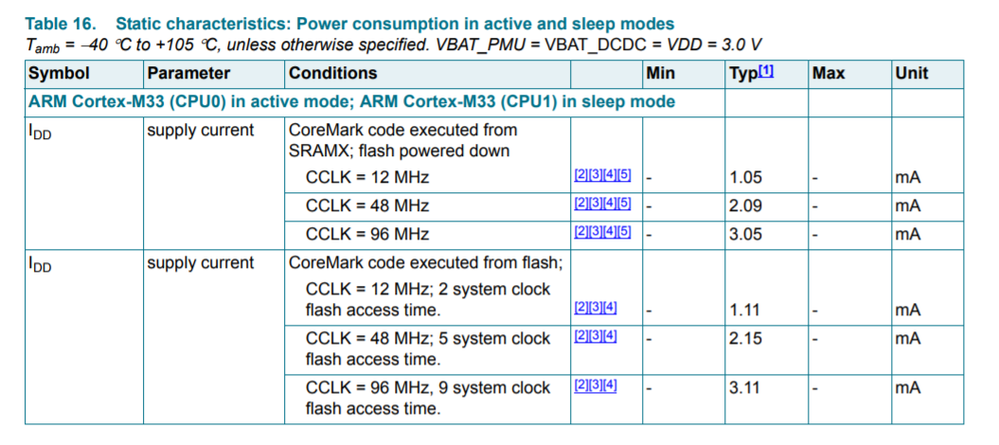

1.  The System Tick timer for CPU1 has three options.
The datasheet shows the current consumption when CPU1 is in sleep mode or off.pastedImage_1.png

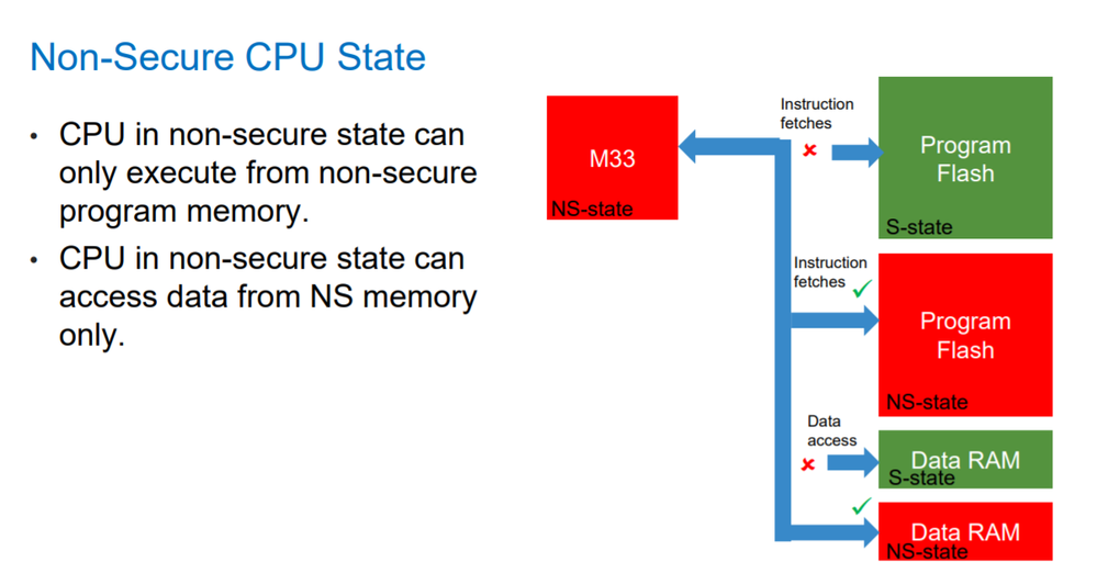

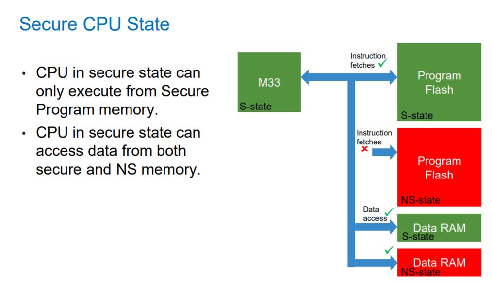

The second question I did not understand what you mean. Here is the basic functionality if the CPU is in secure or non-secure states.
Here are some really great videos that explain in detail, how the trustzone feature works with our LPC55S6x Family.
