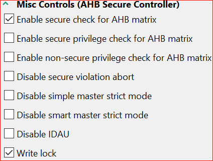

It is not so clear how 2nd and 3rd parameters have effect for security checking.
I mean "Enable secure privilege check  .."and  Enable non-secure privilege check ...".
What AHB check in this case. If privileged code is not access nonprivileged or vise versa.?
Could you provide more info about those checks ?

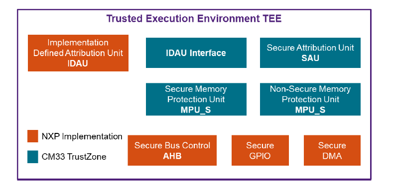

Here is a high level description of what is seen in the tables of the config tools.
The orange blocks are the extension of the security features apart from the blue, which is ARM's security features.
When the secure AHB check is enabled it allows programming security attributes
for all PPCs(Peripheral Protection Checker), MPCs(Memory Protection Checker), or MSWs(Master Security Wrapper). Secure AHB controller provides a second protection layer for safe, trusted execution at system-level. With secure AHB each peripheral is capable of configuring individual access rules. These can be configured in the same config tool  on the previous tabs before miscellaneous.
Consequently when you use secure check and secure privileged check you are doing a combination of ARM's features and the ones implemented mentioned above.

if you enable secure/non-secure privilege check, the AHB secure controller performs additional check for privilege/non-privilege access. In this case privilege/non-privilege access (defined by either secure on non-secure MPU) has to be aligned with AHB secure controller settings. The privilege/non-privilege check can be separately enabled for secure and non-secure bus transactions. The security of transaction is defined by SAU+IDAU.
The AHB secure controller distinguishes between instruction fetch access and data access. In case of instruction fetch, the strict checking is applied. It means that code has to be executed from the same security level. It means that if CPU is in secure-privilege mode, the code memory has to be configured as secure-privilege in AHB secure controller as well. (This is probably reason for your HardFault). In case of data accesses, the privilege code has access to both privilege and non-privilege (user) memory, the non-privilege code has access to non-privilege (user) memory only.
Please note that if CPU is in secure mode, the secure MPU takes effect. In non-secure/normal mode the non-secure MPU takes effect.
Please also note, that if privilege check is enabled, you cannot simply switch to user mode by writing into CONTROL register in thread mode. This is because of strict check of AHB secure controller for instruction fetch. Once you write into CONTROL register in thread mode, the CPU switches immediately into user mode and this causes HardFault. This is because your code memory is configured as privilege. You need to switch to user mode via interrupt (for example SVC). The interrupt is executed always in privilege mode. Now you can set user mode in CONTROL register (because change to user mode will happen during interrupt exit) and modify return address to the new location, which is configured to user access in AHB secure controller. At the end of this interrupt, the CPU change from privilege to user mode and jump to the new location. So code execution continues in  user mode from memory, which configured to the same level in AHB secure controller. The secure/non-secure value is selected based actual secure mode of CPU. You cannot switch from secure-privilege to non-secure-user.
