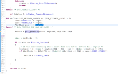

I am asking this question as I am able to recover the AES-128/AES-256 keys pushed from the PUF to the AES key register by the PUF_GetHwKey() API using the non-zero mask parameter. All key bytes are correctly recovered. Also I validated that plaintext/ciphertext is correct for the recovered AES key.
The question is whether I am doing something wrong with setting the mask or the mask doesn't properly work.

Let me clarify one more question. What is the purpose of the "keyMask" parameter of
status_t PUF_GetHwKey(PUF_Type *base, const uint8_t *keyCode, size_t keyCodeSize, puf_key_slot_t keySlot, uint32_t keyMask);
1,465件の閲覧回数
Harry_Zhang
Hi @NewDwarf
The keyMask parameter is used only inside the PUF hardware to add some randomness during the key‑reconstruction process.
Its purpose is to make the internal PUF operations slightly harder to analyze with side‑channel attacks.
It does NOT mask or modify the final AES key, and it does NOT protect the HASHCRYPT AES engine.
So the mask helps only during PUF key unwrapping, not during AES encryption.
You can view the definition of the PUF_GetHwKey function.
