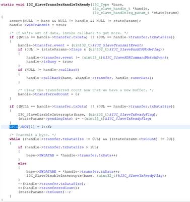

Harry_Zhang
Hi @bell_huang
I have debugged the slave code.
I add one toggle signal.
Harry_Zhang_1-1755077889843.pngHarry_Zhang_1-1755077889843.pngHarry_Zhang_2-1755077910881.pngHarry_Zhang_2-1755077910881.png
The start address header uses open-drain baudrate (typically less than 2MHz), allowing the target more time to fill the TX FIFO and thereby achieve ACK. However, the repeated start address header uses push-pull baudrate, and if set above 4MHz, the target doesn't have sufficient time to fill the TX FIFO, resulting in NACK. Based on current MCU performance, if we want to achieve higher rates, we need to optimize the target code to accelerate its response speed.

Harry_Zhang
Hi @bell_huang
Harry
3,643件の閲覧回数
bell_huang
Thank you for the explanation. As you noted, when the speed is too high, the Slave does not have sufficient time to fill the TX FIFO, so it responds with a NACK.
