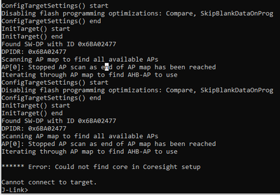

I have been trying to get to the bottom of my inability to attach to a running LPC55S28 target and issue a device reset, and I tried disabling secure boot in the CFPA.
I did this and power-cycled my board, and now the MCU will not enter ISP mode, or allow my J-Link to connect. When issuing "connect" on my J-link I get the following error:
I tried running some of the debug mailbox commands outlined in the user manual, but I could not get these to complete successfully.

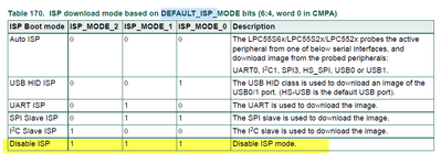

Hello awseiger,
If chip can't enter ISP mode, maybe chip is broken, or disabled ISP mode:
Alice
3,017 Views
awseiger
Alice,
Prior to power cycling the MCU, I did a full read-back of the CMPA. Word 0 in the CMPA was all zeros, so ISP mode was absolutely enabled.
