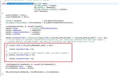

Hello NXP developers, I am an NXP, I am using LPC55S28 to implement DMA to transmit I2S data, I found that the I2S of NXP's official SDK uses DMA to transmit 16 bits, I don't know how to modify it to 24 bits, please guide us. Thank you (bow). A portion of the code is also attached.

Harry_Zhang
Hi @MHY_0878
About the I2S Configuration Adjustments.
#define DataLenth    24  // 24 bits per channel
#define FrameLength  64  // 64 bits per frame (32 bits per channel)
About the DMA Configuration,
You need to configure DMA for ​32-bit transfers​ since each sample is stored in a 32-bit word.
You need to check this function.
Harry

Hello, I've seen this function, I found that it seems that only the modified I2S is used, I generate 16-bit and 24-bit positive sine waves in MCU lpc55S28 for testing, the 16-bit positive sine wave data is normal to transmit with I2S and DMA, but the 24-bit positive sine wave data is transmitted, only the I2S transmission waveform is correct, and the DMA transmission waveform is abnormal, I don't know what the reason is, please help me.

Hi @MHY_0878
I checked the i2s DMA code,
bytesPerFrame is determined based on the width of i2s, so there is no need to modify it.
"the DMA transmission waveform is abnormal"
How do you test DMA waveforms? Can you send photos of the relevant waveforms?
