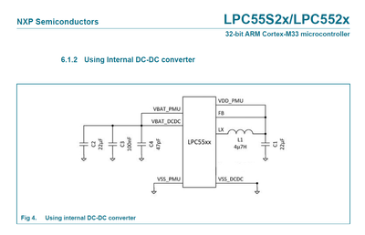

Hello Team,
We are using an LPC55S26JEV98 processor in our design.
Following below mentioned connections we did in our design for power rails.
VDD_1 / VDD_2 / VDD_3 / VDD_4 - are connecting to 1V8
VDD_PMU / VDDA / VBAT_DCDC / VBAT_PMU - are connecting to 3V3
We want to know that there is any problem or issue to connect VDD_PMU / VDDA / VBAT_DCDC / VBAT_PMU the mention supplies to 3V3 voltage level.

As TwoBias said, for the VDD_PMU power supply pin, we suggest you use internal DC/DC converter for the VDD_PMU power supply as the following Fig. The VDD_PMU power supply input voltage is from 1.1V to 1.2V, which can be controlled with software based on the core frequency.
It is okay that
Hope it is helpful
XiangJun Rong

TwoBias
you should not connect VDD_PMU to 3,3V.
It is core supply and maximum voltage is 1,26V.
You should connect it with the DCDC output path and FB Pin.
