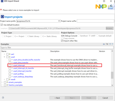

Using an LPC55S16 to communicate via UART.  Unfortunately, the system has some noise, and the RX line is occasionally pulled low momentarily, which the UART interprets as a start bit.  This ultimately leads to a framing error.
What is the suggested methodology for recovering from a framing error?  I'd was thinking just vector on a framing error, reset some flags, and throw out the byte.  But this is just a high level concept.  Can I please get a detailed description of what should be done in this situation?
Thanks!

@Harry_Zhang  I am currently working in a polling mode where this issue occurs when using USART_READBlocking( which returns 0x5711, framing error).  What to do in this situation?  Thanks.

Harry_Zhang
Hi @JK_265
This means that the received frame is incorrect.
I suggest you use this example to automatically discard frames when they are received incorrectly, and receive frames when they are received correctly.
Harry
2,146件の閲覧回数
Harry_Zhang
Hi @JK_265
I think you can refer to lpc55s16_usart_interrupt example.
But you need change some code.
USART_EnableInterrupts(DEMO_USART, kUSART_RxLevelInterruptEnable | kUSART_RxErrorInterruptEnable);
change to
USART_EnableInterrupts(DEMO_USART, kUSART_RxLevelInterruptEnable | kUSART_RxErrorInterruptEnable | kUSART_FramingErrorInterruptEnable);
