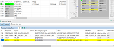

could you help me to configure ADC for channel 8 (i.e, ADC0_8 ,   PIN P0_16)

We can utilize this easily with pin config tool. see below configuration
after the configuration, generate code. we will see the related code in pin_mux file.
