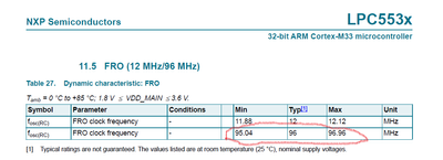

xiangjun_rong
This is the FRO 96mHz accuracy, it can reach up to 96.96mhz at most.
I copy it from data sheet of LPC553x.
Hope it can help you
XiangJun Rong
