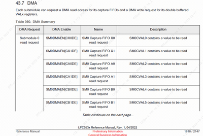

      Below is a doubt that I can't understand, can you help to give some explanation ?
      Thanks very much.
       1>DMA for PWM in LPC5536 Reference manual
        2>DMA request in MCUXpresso Config Tool (V13.0)
    3>Question
       I can't find the relationship of DMA request channel for PWM in RM and config tool.

Hello @jimmyli
Sorry for reply you late, I just got reply from our internal SE team.
 "the eFlexPWM should only have DMA triggers, not requests."
Our SE team member has reported to Config tool team.
Sorry for the inconvenient to you.
