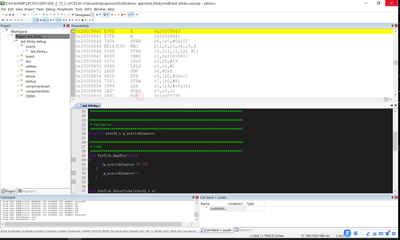

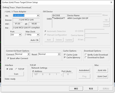

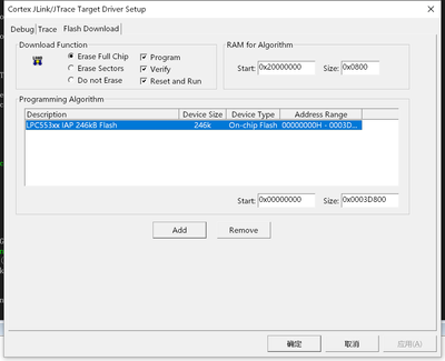

Hello, I want to know how to use LPC5536 EVK editing routine (SDK) and Keil development environment to change the onboard McU-link to Jlink. The program can be downloaded normally, manually reset after download can be used normally, but KEil can not debug. What's the reason, please?
_0-1663919420359.png_0-1663919420359.png_1-1663919444499.png_1-1663919444499.png_2-1663919502494.png_2-1663919502494.png
According to disassembly, where does it stay forever, unable to debug

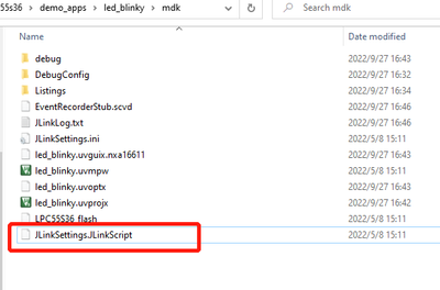

Hi @胡绍广
Please remove this file from the demo code folder. This should work.
