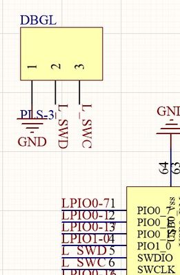

SWD clock is configured in MCUXpresso. Connection between MCU and SWD pins is ok. I tried to pull ISP entry pin to VCC and GND, nothing changes.

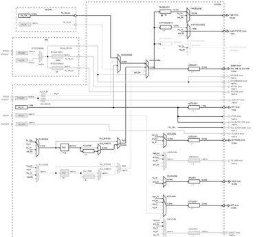

SWD connected directly to the programmer:
Clock configuration:

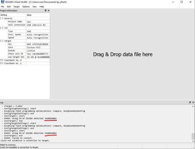

And the error code(in SEGGER J-flash, MCUXpresso returnes the same code):

Hello alex,
You can have a look at this thread:
https://forum.segger.com/index.php/Thread/4302-SOLVED-Target-Connect-J-Link-Error-Check-connection-a...
And about the J-link debug, recommend you also ask help on Segger support, they know the j-link deep.
https://www.segger.com/
