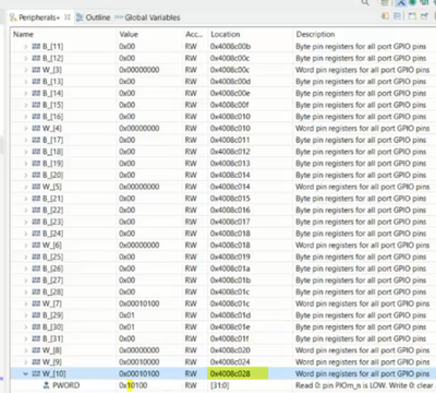

Strange behavior on PIO1_10 on LPC5528.
Doing :
BOARD_INITPINS_PWR_Down_PORT=1
BOARD_INITPINS_PWR_Down_PIN=10
GPIO_PinWrite(BOARD_INITPINS_PWR_Down_GPIO, BOARD_INITPINS_PWR_Down_PORT, BOARD_INITPINS_PWR_Down_PIN, 1);
Pin stay at 0, and reading base->B [port] in debug windows show the pin at 0.
This pin can be configured as FLEXCOMM1 that I did for testing, and stay at 0 during SPI communication.
On the board the pin is not short to GND.
When redirecting that connection to another (PIO0-24 for the case) everything come right.
On the rest of the board I use 10's of other pin configured in the same manner and everything is fine.
What happened for that specific PIO1_10?

Which version of IDE do you used? I test LPC5528 project, the register memory view is the same with Lpc55s18.
Any way , do not check w[10], mainly check the address  0x4008 02a.
And I also use DS measure the P1_10 pin, it can set to 1, it can toggle, there is no problem. see my attachment video.
Recommend use my project, then use logical measure the p1_10. If still not work, check your hardware.

I check in fsl_gpio.h:
static inline void GPIO_PinWrite(GPIO_Type *base, uint32_t port, uint32_t pin, uint8_t output)
 base->B[port][pin] = output;
} <- break points
at the break point i check base.B[1]
other pins are correct P1_10 stay at 0.
if you think it is because it is too fast
just
GPIO_PinWrite(BOARD_INITPINS_Test_GPIO, BOARD_INITPINS_Test_PORT, BOARD_INITPINS_Test_PIN, 1);
out of the loop
does not pass PIO1_10 to one
but other pin test2 switch well on the scope and at the debug BP
Using your window "Peripherals"
i can see SET1.SETP that move and display 0x400 at 1
but PIN1.PORT does not.
So i thing my chip has a problem, it came from mouser, i am "esd aware" and as soon as i had opened the bag i had soldered it with minimum manipulation.
In anyway i have made a strap on another pin and it is ok.
JP

Which IDE do you used? Please take a screenshot about the data of register you got.
Pay attention the GPIO port register address of P1_10.
Alice

Hello ,
I take  a video on my side,  please see my attachment.
Pay attention, it seems there is issue in Peripherals view with MCUXpresso IDE v11.4.0.
so just  notice the address of 0x4008 02a
I also attached my project.
Alice
17,226件の閲覧回数
jplathuile
Despite your are using a 55S28, i can import and run your project on my 5528. That is what i did... and W[10] stay at 0.0.
your W[10] register is at 4008C028 mine at 4008D028 !. At 4008C028 i have B[40] witch stay a 0 (on your project )
But it is not a problem of debugger it is that the pin stay at 0 on the card.
I think that there are register that reflect what should be on the port (SET register) and register that reflect what is really on the port (B).
For my case i thing the pin is fried and do not respond.
JP
