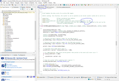

xiangjun_rong
Hi, Francois,
Pls refer to the description of the api function void SCTIMER_UpdatePwmDutycycle() in fsl_sctimer.c, the duty cycle range is from 1 to 100, it can NOT be 0.
Hope it can help you
XiangJun Rong

francoisB
I knew it but I forgot to initialize the dutycycle of the 4 channels to 1 (instead of 0).
I replaced every "dutycycle = 0" by "dutycycle = 1".
In fact, there's no glitch anymore because it is replaced by the dutycycle at 1. This is not really a solution because my LEDs stay slightly illuminated.
