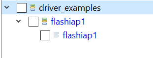

Hello @Zhang_123
For this part, the Flash size customer can use is 256K.
About Flashapi using, you can refer to SDK demo "flashiap1":
Alice
