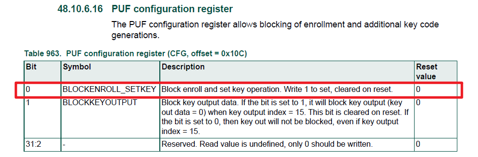

I'm using the 1B version of LPC55S69.
When setting the BLOCK_SET_KEY to 01b (Disable PUF Key Code generation) of the SECURE_BOOT_CFG in the CMPA, blhost's receive-sb-file can't work with aborting.
If we'd like to use receive-sb-file, do we have to set the BLOCK_SET_KEY to 00b (Allow PUF Key Code generation)?
In my testing, when setting BLOCK_SET_KEY=00b and BLOCK_ENROLL=01b, SEC_BOOT_EN=01b, then receive-sb-file is working fine. However when setting BLOCK_SET_KEY=01b and BLOCK_ENROLL=01b, SEC_BOOT_EN=01b, then receive-sb-file failes with Abort Error.
Why does receive-sb-file need BLOCK_SET_KEY=00b?

I did attempt several ways which now I am unable to recover the board at the moment. The feedback I received form our application team is the following:
If you follow AN12283, it will config the CMPA by using elftosb-gui like you mentioned, and then loaded the SBKEK(sb key for sb file decryption) to device. SBKEK provisioning is depending on PUF, it needs PUF to generate key code for SBKEK.
So if disable PUF key code generation before, then provision SBKEK, this will cause the key provisioning to fail.
After each reset, ROM will config PUF based on PFR settings.
For LPC55S69, it has ONE bit in PUF configuration register to block enroll AND set key, as shown above.We should provision the key that the ROM needs first, then block the PUF as needed.
Sabina

Here is a further update:
The root cause is not PUF. It is because the PRINCE has been enabled, but doesn't follow the flash operation rule mentioned in AN12283.
We also have AN12527 for PRINCE.
The whole flash region covered by PRINCE should be erased and programmed. "receive-sb-file" command doesn't guarantee that this rule is met.
The problem is that both applications note run the PUF enrollment (-- key-provisioning enroll). But this command must be called only once because the activation code gets re-write; either the SBKEK or PRINCE key is invalid. Therefore, the device cannot get out of the ROM boot.

Hope you are well. At the moment I am relying on our application's team test and details regarding this issue. Unfortunately, I do not have access to another board at the moment working from home. I did make initial tests but have not been able to recover the current board I am working with.
The information received is that they were able to follow the steps you have taken without any problem. In addition, it is a must to do flash-erase-all before using the receive-sb-file command. When you issue this command, the intent is to do an update of all the software image.  Therefore, you need to start from scratch.
A similar concept applies to PRINCE. Every time there's an image update, new PRINCE IVs are generated, making the data already saved invalid. A workaround for not losing information is to use the ping-pong data, get the old IVs to recover information, then re-encrypt with the new IVs.
