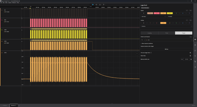

This is what I'm receiving. As you can see the first byte is duplicated on the first packet, and not on the second:
I've checked the signal with a logic analyzer, and can see the repeated byte going over the wire, so it does seem to be generated by the LPC, and not an artefact of the receiver.

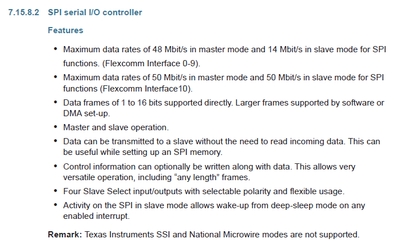

Harry_Zhang
Hi @andrewsglenn
You can refer to the LPC540xx/LPC54S0xx Product data sheet.
Hang
6,346件の閲覧回数
andrewsglenn
Hi Hang,
I'm not sure how that applies. 6.25 MHz is less than 14 MHz, so should be fine. My question was if the interrupt service routine could keep up with reading and writing 512 bytes at 6.25 MHz without overflowing.

andrewsglenn
Is it expected for the MISO line to tail off like this when you're using it as a slave?
