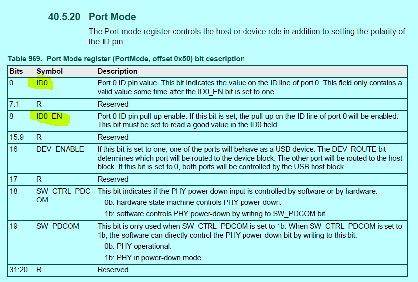

another question, how to read the value from the USB1_ID pin? seems that is not a standard GPIO

terence_kong
Any idea how to read the value from the USB1_ID pin?

diego_charles
 Hi Terence!
I apologize for the delay! I missed the track of your inquirie due my workload.
You can check the value of the  USB1_ID pin!
Altougth this pin  does not have a GPIO alternative like USB0_ID.
To do this please,  refer to the  register PortMode of the LPC546 UM
This is the small code  that I made to   test the  USB1_ID pin :

Additional comments:
This was tested using the LPCxpress54628 EVK. I can guarantee that this example code will work as intended on all situations!
To pull down the USB1_ID line I used to connect a OTG adapter to the high speed USB connector, since has the ID pin grounded.
I hope this helps!
