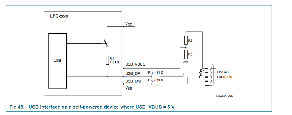

Figure 48 from the LPC546xx datasheet shows the pullup on USB_DP being switched from Vdd. However my understanding is that the USB specification requires this to be connected to USB_VBUS.
Given the problems I have seen with regard to USB device enumeration I suspect that the figure is in fact incorrect and the device does switch to USB_VBUS, but I would appreciate it if someone could confirm this detail. Also, if the minimum working voltage for the USB_VBUS could be provided that would also be very helpful.

I have confirmed with AE team, the "Fig 48. USB interface on a self-powered device where USB_VBUS = 5 V" is correct, the USB_DP is pulled up to VDD instead of USB_VBUS with the DCON bit is set in the DEVCMDSTAT register.
Regarding the minimum voltage of the USB_VBUS pin, it is VDD*0.7, if the VDD is 3.3V, it is 0.7*3.3V=2.3V.

However, I find the details concerning since I my understanding is that the USB standard requires that USB_DP be pulled up to VBUS and not VDD; or at least that the pull-up should not be attached if VBUS is not present. Can you confirm how this works on the LPCxxx?
Also, from my own testing I can say that USB device enumeration will fail if the voltage on the USB_VBUS pin is below 2.9V. It certainly does not work anywhere close to 2.3V!
