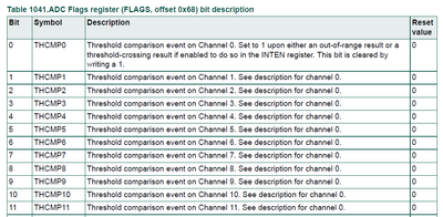

So I've been using the ADC0 - channel 9 on the LPC546xx to try and setup a threshold comparison interrupt - triggering above roughly 2 volt. This triggers fine but I can not seem to clear this triggered status, the IRQ handler always seems to fire no matter what (resultantly halting the program), even when removing the power supplies VDDA, ADC0, VD2_ANA, VREFP, TS - and the ADC clock (causing ADC_GetStatusFlags(ADC0) used in the interrupt handler to return 0) and still the interrupt fires, ive tried manipulating the relevant bits in the NVIC registers: clearing the NVIC->ISPR[0] (only the correct bit) and setting NVIC->ICPR[0] (only the correct bit) etc, from what i can determine some internal sequence or hardware routine must stay alive and keep updating NVIC registers, that or i cant overwrite them for some reason (never tried before), same with ADC0->FLAGS (which holds the threshold compare int trigger bit) and ADC0->GDAT[0] (ADC_SEQ_GDAT_RESULT holds the last result and ADC_SEQ_GDAT_CHN is the corresponding channel - which seem valid) registers, but I can set all the other ADC0 registers (CTRL, SEQ_CTRL etc) to zero. Any ideas would be appreciated, all im trying to do is trigger on a threshold, remove the physical trigger condition, then clear the interrupt so it can be triggered again.

2,431 Views
xiangjun_rong
Hi, Korey,
I suggest you check each THCMPx bit in the following ADC FLAGS register, if one bit is set, clearing the bit by writing a 1 to the bit. I think it is okay to write 0x3FF to the ADC FLAGS register so that you can clear all bits. Pls have a try.
Xiangjun Rong

2,418 Views
koreycyrus
Yeah that did it, thank you!
