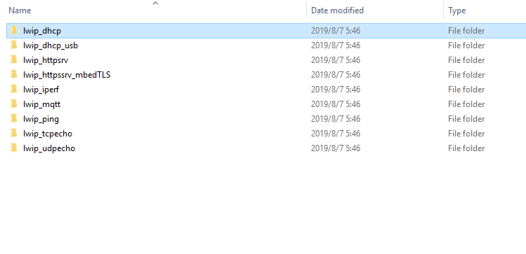

In the SDK package, we have ported the FreeRTOS and LWIP for Ethernet stack, we have example for the LWIP example based on FreeRTOS or BM(Bare Metal). .
Regarding the Http server, as the following fig which demos the LWIP examples. there is http server example. I suppose that we have not the DNS example which can convert the web name to the IP address.
