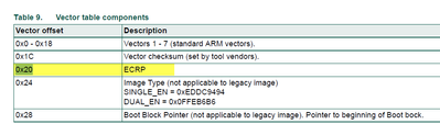

The offset address of ECRP is0x20:
From the returned value of ERASE command, I think you configure the ECRP or OTP .About ECRP, config it in image at offset 0x20. OTP, there is OTP API, detail you can refer to "Chapter 46: LPC546xx One-Time Programmable (OTP)".
Alice
35,507 Views
giusloq
The offset address of ECRP is 0x20:
Even ECRP word at address 0x20 is 0:
R 32 4
0
00 00 00 00 <- binary
I never wrote to OTP memory (at least intentionally), so if I understood well, CRP_ALLOW_ZERO bit is 0, so ECRP=0 is interpreted as:
All protections enabled by ECRP field will be set to lowest protection level. So, flash ECRP value is interpreted as SWD, ISP entry, IAP entry, write and erase of all flash sectors are allowed.
So SWD should be enabled.
I don't think I wrote OTP memory unintentionally, because I should had used OTP API, so I should had called otpInit() and other similar functions. There isn't any of this in my code.
Is there any way to read OTP memory with UART ISP?
