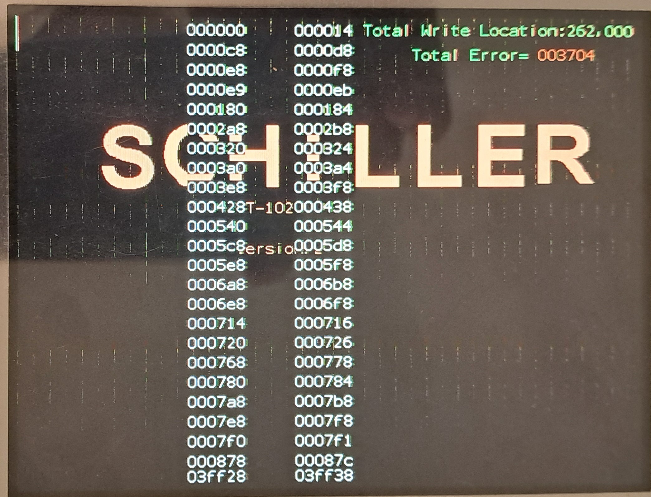

For your information, I am using both SDRAM and SRAM via EMC. SRAM is used for the keypad application, which is working fine, while SDRAM is used for the display, where I can seeing data corruption and patches. I tested the SDRAM read and write operations using the SDK sample code emc_sdram.c and observed errors in the read operation (~1% error).

nithin3200
Hi @Harry_Zhang,
1) "Can this problem be reproduced?"
As per your request, I have reproduced the problem and am sharing the screenshots for 37.5MHz and 50MHz.
2)"Can you share your testing method?"
I am also attaching the screenshots for the SDRAM read and write functions.
Please have a look at the attachments.
Nithin

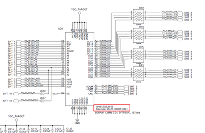

You mentioned, "LPC54628 board with the W9812G6JB-6I works fine, can you change LPC54628 board to IS42S32160D-6BL, or change the custom board to W9812G6JB-6I?" How can I change the LPC54628 board to IS42S32160D-6BL when there are no connectors for the SDRAM interface? Could you please provide more clarity on this?

Harry_Zhang
Hi @nithin3200
According to the schematic diagram of the board, You can replace 'W9812G6JB-6I' with 'IS42S16800F-6BLI', If it can work normally after replacement, it indicates that there may be a problem with the customer's board.
