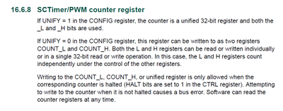

Thank you for your reply,I use two 16-bit counters to produce two pwms,but when I try to change their duty,it case a HardFault_Handler.
  MY code:
 i = SCT0->EV[eventCounterH].CTRL & SCT_EV_CTRL_MATCHSEL_MASK;
SCTIMER_StopTimer(SCT0, kSCTIMER_Counter_H);
SCT0->MATCH[i] = (5-1)<<16;
SCT0->MATCHREL[i] = (5-1)<<16;
SCTIMER_StartTimer(SCT0, kSCTIMER_Counter_H);
                                                                                                                thank you!
