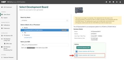

gusarambula
Hello Evan,
I understand that you may prefer not to install additional tools or IDEs, but it is the easiest way to setup the PLLs for your application, albeit not the only one.
If you are open to a compromise you may install the MXUXpresso Config Tools as stand alone so that you can use the Clocks Config Tool, which makes the process much less cumbersome.
Alternatively, if you rather not install any additional software at all, you may use the web version of the Clock Config Tool to aid on the setup of the PLL registers.
Go to the MXUCpresso Builder homepage (link below) and after selecting your board you may build the MCUXpresso SDK or explore the Pins Tool and Clocks Tool on the web.
https://mcuxpresso.nxp.com/en/select
I hope that this information helps!
