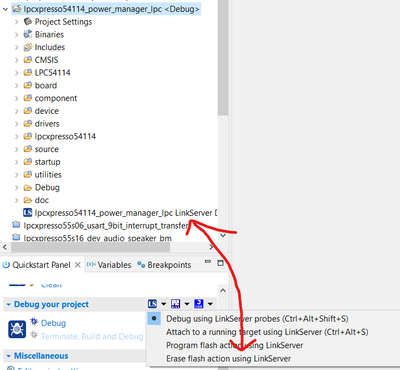

Pavel_Hernandez
Hello, could you share with me an image of the error in the IDE? Are you using an EVK board? if you do a mass erase and try again what is the behavior? you could do this in the IDE the next image is an example.
