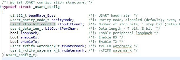

canbazonur
I have no idea how can I change the register value of LINMODE. Could you send one example code ? I could not find any terms related with this register under _usart_config structure.

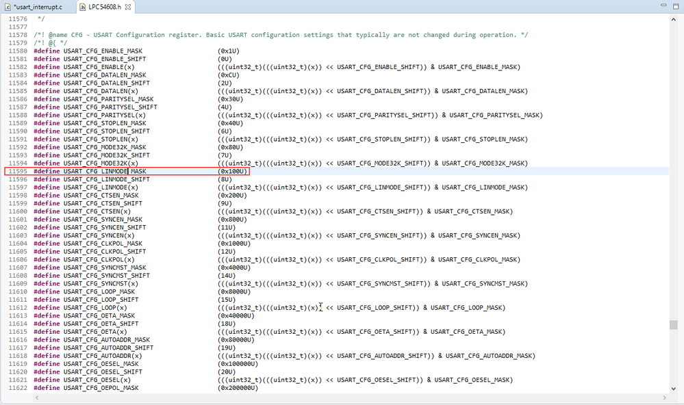

victorjimenez
Hello Anıl Onur Canbaz,
In the file LPC54608.h of the SDK you have the mask to activate the LIN mode.
So you just need to write to the CFG register using this define.
Victor.

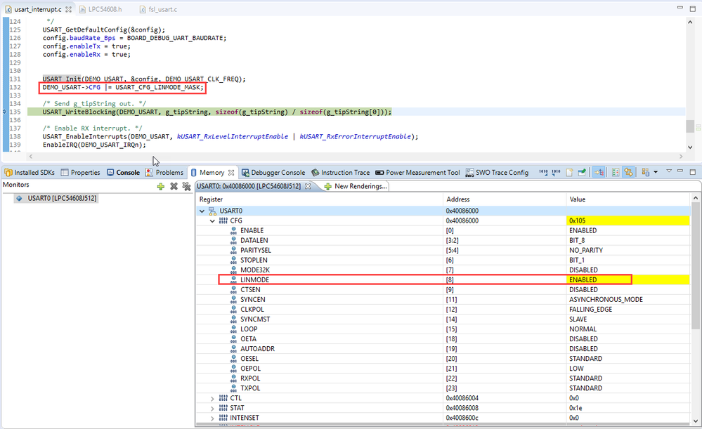

victorjimenez
I recommend you check the following community post where one of my coworker explained in a more detail way about the LIN bus of the LPC546xx and provided an example project.
Break detection on LPC 546xx
Hope it helps!
Victor.
