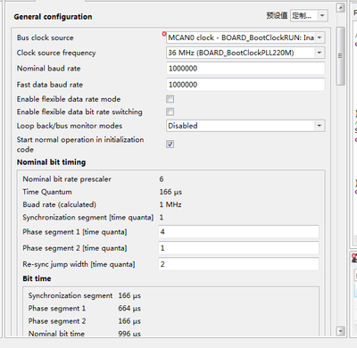

I dont not know how to set CAN BUS buadrate to 1MHZ.I use classic CAN.
I have changed the can0 clock frequency to 36 MHZ by use this function “CLOCK_SetClkDiv(kCLOCK_DivCan0Clk, 5U, true);” .
when I set can bus buadrate to 500khz,I find that it worked normal,the configuration is :

when I set can bus buadrate to 1000khz(1Mhz),unfortunately,something I can not predict has happened,it has send data 13 times by  called this function “MCAN_TransferSendNonBlocking(EXAMPLE_MCAN, &mcanHandle, &txXfer);” one time,and the
“”txComplete” always equal to FALSE, the configuration is:

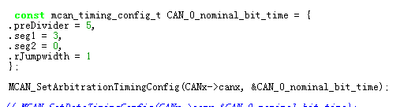

I used  MCUXpresso configuration tool configure the clock, baud rate,then it can send data normally,but it can not receive,I do not know  what make that happened.

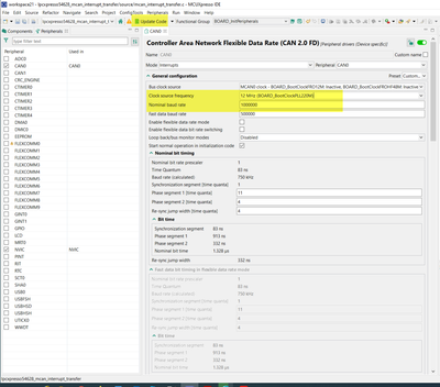

First recommend you use the MCUXpresso Configure tool to config the CAN module to 1MHZ to test,
check whether it can work well.

Use MCUXpresso configuration tool can just configure the clock, baud rate as your requirement, then it
generate  code automatically , you can compare the code with your code to check whether the code is configured well.
