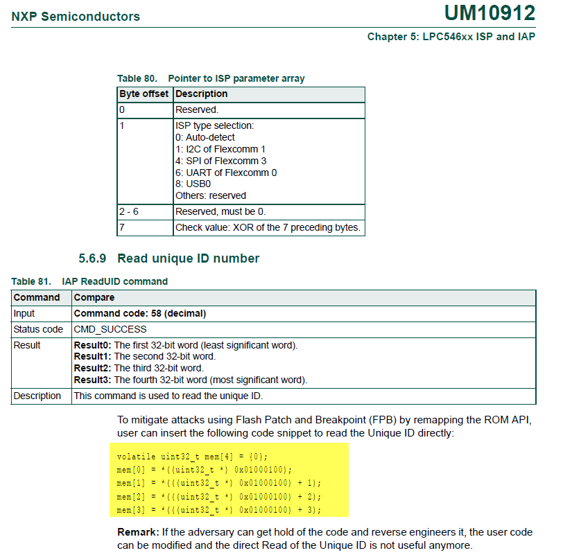

Hi all,
I am trying to read the 128 bit unique ID from the LPC54616. There is an IAP routine, but other answers suggest it can be read from a flash address directly. Can anyone confirm this address?

We can read LPC546xx UID from address from 0x01000100 to 0x01000103.
See user manual, I highlight the code as below:

Thanks very much, I was using rev 2.1 of the user manual which didn't have this. Perfect
