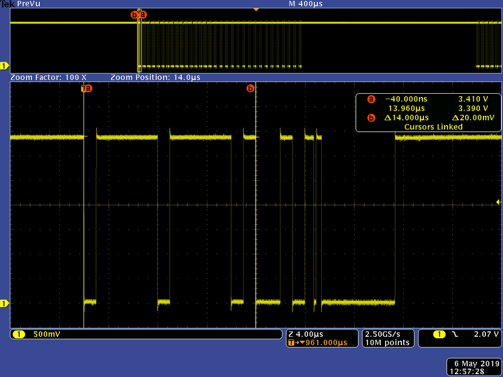

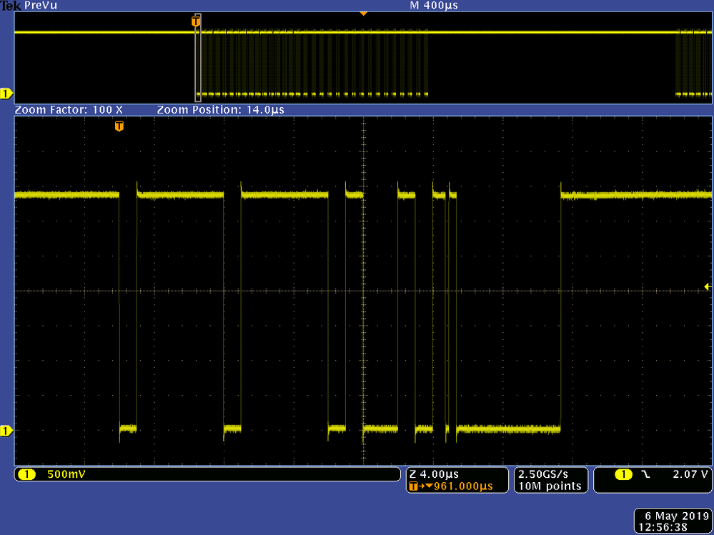

Here are the oscillograms I used to validate timing and show the problem.
This one has the frame that was transmitted and shows the interface trying to resync in the MagniVue area (top).
Next one measures the timing of the sync, 11 bit ID of 0x7FF with 2 stuff bits. At 1 MBits/Sec that is 14 bits and 14 us.

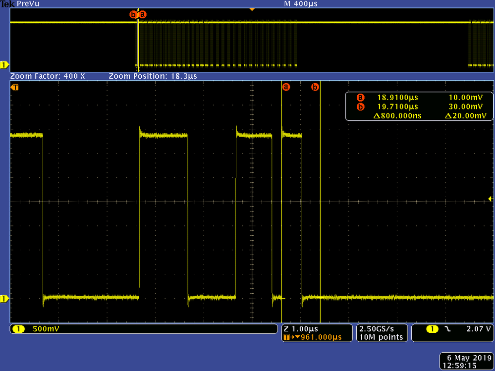

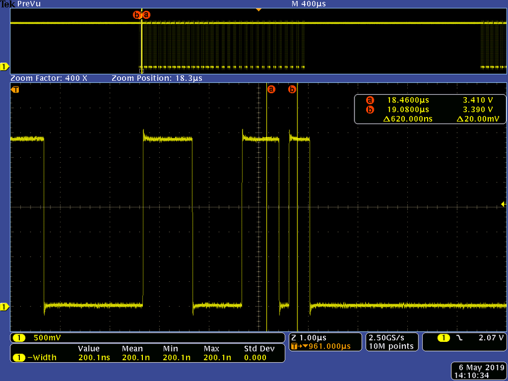

Let's verify the width of the ESI bit to see if it is at 5 MBits/Sec (200ns).
With a 12 byte data payload the DLC value (0-800ns after the ESI bit) should be 0x9 but I'm seeing 0xC and then bad data (no 55 56 57 58 59 5A 5B 5C 5D 5E 5F 60).
That's as far as I've gotten on this. Have not looked at the ACK/NACK on the other side or the dump of the interrupt and status registers yet.
