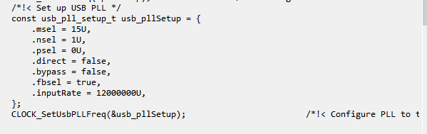

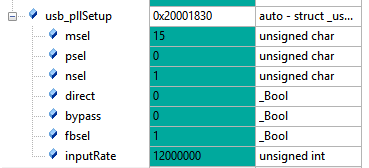

carstengroen
Senior Contributor II
Thanks Tang,

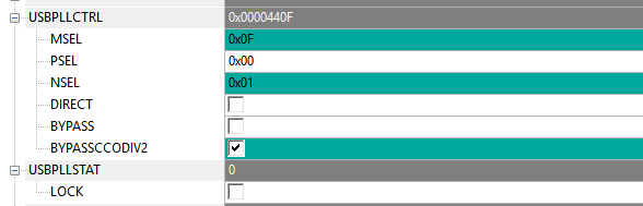

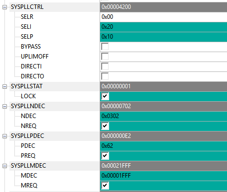

I figure I must do something wrong. I followed the CLOCK-SetUsbPLLFreq() function, the pll_setup looks like this:
I can follow the function until it waits for a lock, which never happens!
The USBPLL registers (from SYSCON) looks like this:
When looking at the SYSPLL (which runs at 180 MHz from external xtal), the registers looks like this:
Is there something more I can check to narrow what I have done wrong ?

Dezheng_Tang
If th lock never happen after USB PLL configured, while SYSPLL at 180MHz works using xtal, then, your M, P, N, values or mode may be wrong. Have you tried the value and mode from SDK?
