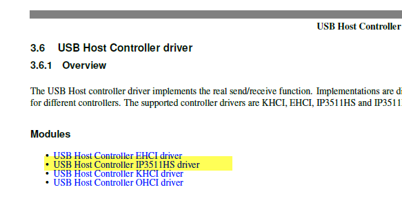

The USB controller driver implements the real send/receive function. Implementations are different
for different controllers. The supported controller drivers are KHCI, EHCI, IP3511HS and IP3511FS.
You can find more information about these controller drivers in the USB Stack Host Reference Manual and USB Stack Device Reference Manual, these document are located, after install MCUXpresso SDK at the path:
<LPCXpresso54608>\docs\usb

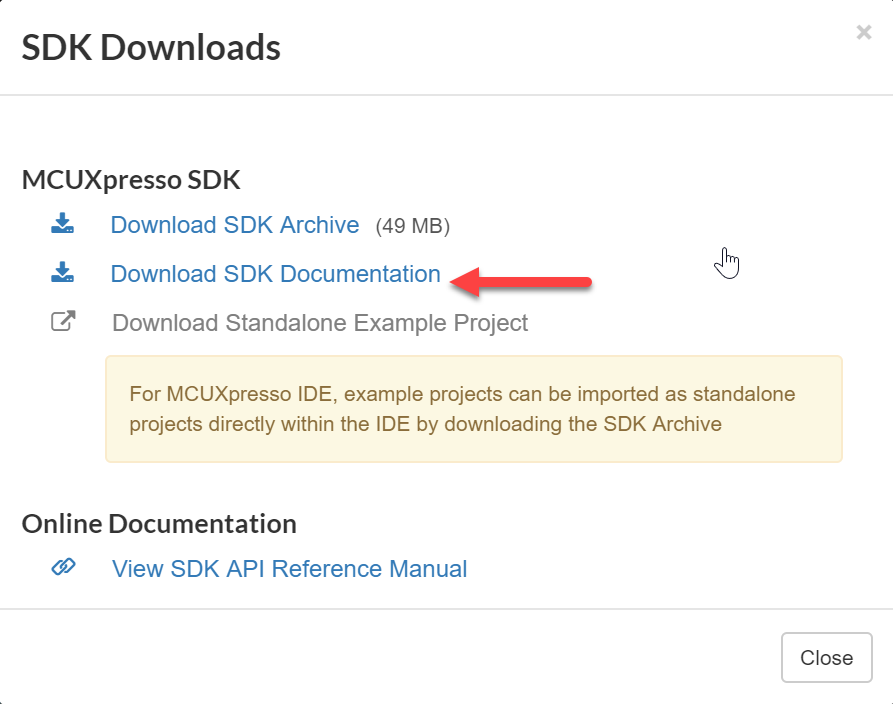

Does anyone know where I can find the latest version of this document (USB Stack Device Reference Manual)?
I can't seem to find it in the MCUXpresso SDK I downloaded.
3,305 Views
soledad
There is a separate folder that you need to download from the SDK link,
3,305 Views
arno1
Thanks. I totally skipped that link because the SDK downloaded automatically.
