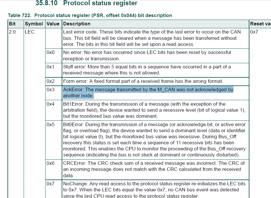

  Answer: Actually, you detect the bus off status in the according register PSR[BO], if the BO is 1, it means the CAN is in can bus off mode. you need to do the can bus off recovery process, the detail information you can refer to the content in the user manual:
2 - when there are NO nodes connected in the bus (i.e. when the tranceiver is not conneced on can bus)  the code hangs in the while loop after the MCAN_TransferSendNonBlocking waiting the write completion:
Answer: If there No nodes in the CAN bus, you send the can data, you will meet the problems, you also can detect the errors in the register:
Actually, before you send the CAN data, you must make sure your external hardware CAN tranceiver is connected, other wise the the status register will report the error code.
Wish it helps you!

    I have checked the SDK sample code, it doesn't have the bus off code, so we need to write it by referring the user manual.
   Here, I will give you the step:
1. check the PSR[BO], if it is set, it means the bus off, we can do the bus off recovery process.
2. Clear INIT bit, to start the bus off recovery
3. use while to wait the bus off recovery is finished,
  Check PSR[LEC], if it is 0x5 and PSR[BO] =1, just wait.
Eg, while((PSR[LEC] ==0x5)||(PSR[BO] ==1));
After the while is run over, it means your bus off is recovery.
You can try it on your side.
Besides, you also can use the interrupt to detect the bus off, but you need to enable IE[BOE], and clear IR[BO]in interrupt handler. then do the bus off recovery process.
