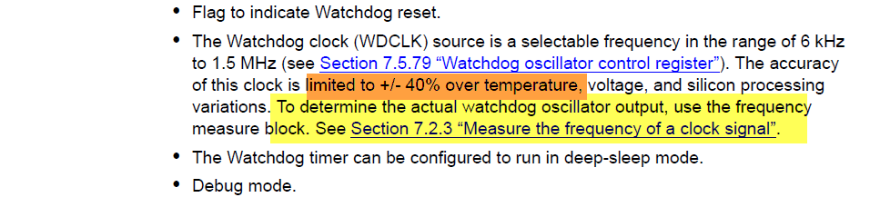

Hi Rex Lam,
    Please check the user manual description:
So, actually, the watchdog clock have the accuracy, it is +/-40%, this is very larger, as you know, even you get 1.56s, the accuracy is about 22%, it still meet the watchdog demand.
If you don't believe it, you can use the clock out to check the watchdog clk, this clock should already have the accuracy problem, this is the root problem caused the 1.56S time out problem.
Actually, it is not the issue, it is just the chip feature.
Wish it helps you!
Kerry
