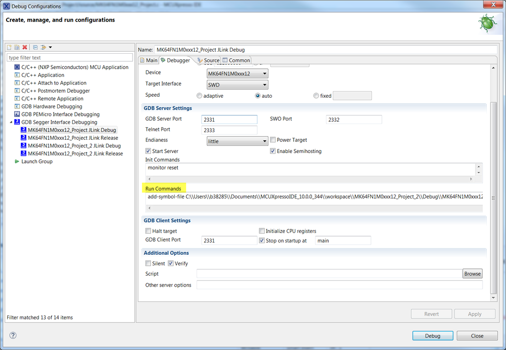

You can debug both the bootloader and the application by adding the following command to your debug Run Commands in the bootloader debug connection:
add-symbol-file filename address
As an example:
add-symbol-file C:\\Users\\Documents\\MCUXpressoIDE_10.xxx\\workspace\\MK64FN1M0xxx12_Project_2\\Debug\\MK64FN1M0xxx12_Project_2.axf 0x80000
The address 0x80000 corresponds to the first flash section of the second project which was previously flashed to the MCU:
Hope it helps!

but.... I'm using the MCUXpresso LinkServer Debugger with the OM13092 lpclink onboard debugger for my first tests and then I use an LPC_LINK2 debugger for my custom target board (via SWD connection), so I can't find the "add-symbol-file filename address" equivalent settings you suggested for my debug configurations. I think your solution is right for the Segger debug interface, isn't it?
Is there an equivalent solution for the LinkServer debugger configuration for loading and debugging both the bootloader (@0x0000 address) and the main app (@0x8000 address) projects?
