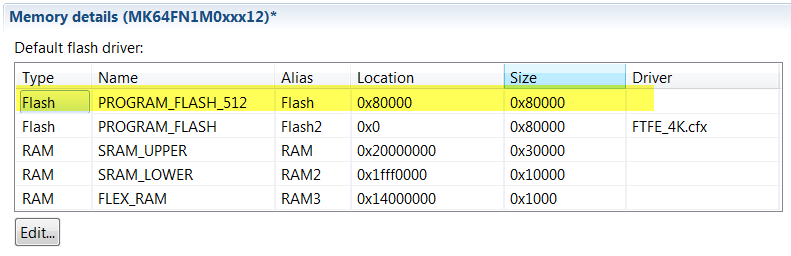

You can debug both the bootloader and the application by adding the following command to your debug Run Commands in the bootloader debug connection:
add-symbol-file filename address
As an example:
add-symbol-file C:\\Users\\Documents\\MCUXpressoIDE_10.xxx\\workspace\\MK64FN1M0xxx12_Project_2\\Debug\\MK64FN1M0xxx12_Project_2.axf 0x80000
The address 0x80000 corresponds to the first flash section of the second project which was previously flashed to the MCU:
Hope it helps!
