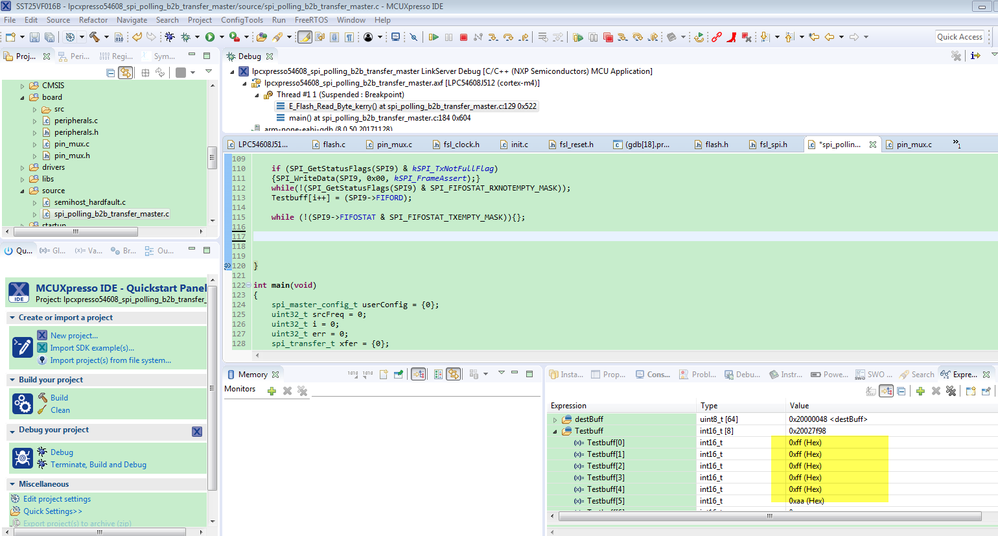

Hi Fatih ozen,
   After I modify your API, now it can get the correct data, please check my attached result:
int32_t E_Flash_Read_Byte_kerry(uint32_t ui32Address){
     int16_t dummy,dummy20, Testbuff[8];
     uint8_t i=0;
     uint32_t dummyTest=0;
     for(i=0;i<8;i++)
          Testbuff[i]=0;
     //CE_Clear();
     i=0;

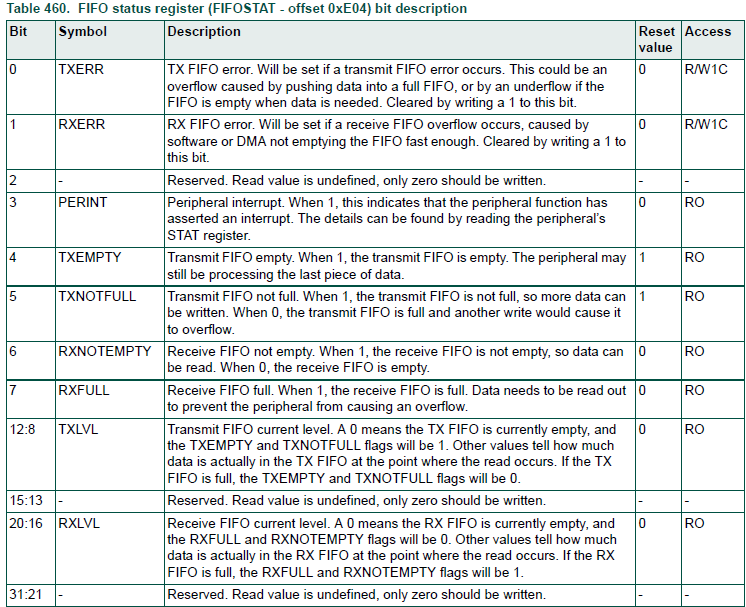

     SPI9->FIFOCFG |= SPI_FIFOCFG_EMPTYTX_MASK | SPI_FIFOCFG_EMPTYRX_MASK;
     while(SPI_GetStatusFlags(SPI9) & SPI_FIFOSTAT_RXNOTEMPTY_MASK)
          dummyTest = SPI_ReadData(SPI9);//Put breakpoint here, if it really won't enter, this while code can be delete.
     SPI9->FIFOSTAT |= SPI_FIFOSTAT_TXERR_MASK | SPI_FIFOSTAT_RXERR_MASK;
     if (SPI_GetStatusFlags(SPI9) & kSPI_TxNotFullFlag)
     { SPI_WriteData(SPI9, 0x0B, 0);}
     while(!(SPI_GetStatusFlags(SPI9) & SPI_FIFOSTAT_RXNOTEMPTY_MASK));
     Testbuff[i++] = (SPI9->FIFORD);
     {SPI_WriteData(SPI9, 0x00, 0);}
     {SPI_WriteData(SPI9, 0x91, 0);}
     {SPI_WriteData(SPI9, 0x00, kSPI_FrameAssert);}
     while (!(SPI9->FIFOSTAT & SPI_FIFOSTAT_TXEMPTY_MASK)){};
Just use while to wait the received status finished.
Your problem is caused by the received data is not received with if, but use while to wait, it will be enough time to get the received data.
Please try my new function again with your external flash
Kerry

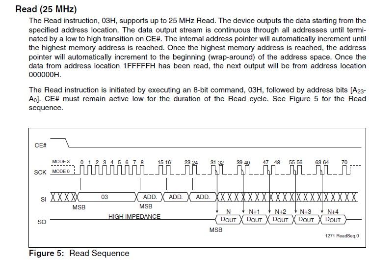

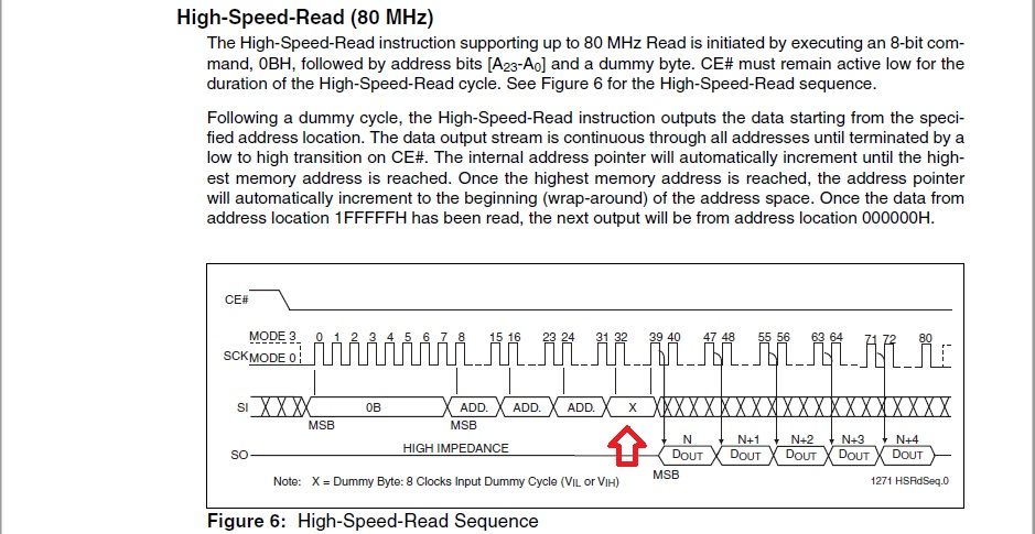

kerryzhou
Hi Fatih ozen,
   I highly suggest you to use the logic analyzer tool to check the SPI bus wave.
   Then compare the SPI bus wave with your external SPI flash datasheet waveform and requirement, whether it meet the slave's demand?
   Another point you need to note, normally, use the MCU to control the external flash SPI interface, the SPI_SSEL we use the GPIO to control it, instead of the hardware SPI SSEL pin function.
   You can check the SPI bus wave, whether the SPI SSEL pin wave also correct with your code.
  Check the BUS wave will help you to locate the root problem.
Wish it helps you!
Kerry

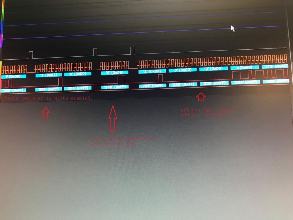

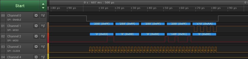

fatihozen
Hello Kerry Zhou,
I did as you said now I can read write status register correctly and the successful about reading jedec ID. Problem is still about reading a byte. I am erasing all datas via Chip Erase Command and then write a byte to an address (0x000065) (Data : 0xAD). and then I try reading this byte from same address via reding command. I see data is on MISO line but I still see 0xff on my screen. Screenshots are below.
I little bit changed the code as you see below.

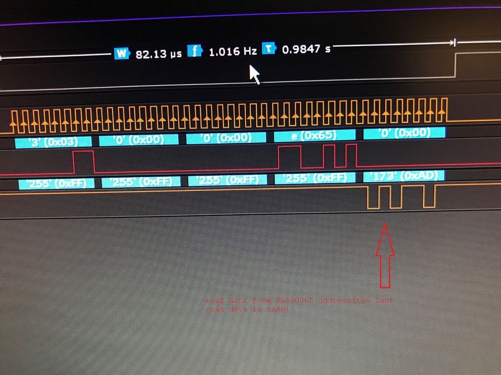

Hi fatih ozen,
      Thank you for your updated information, it's good!
      Now,  your problem just in the external flash read.

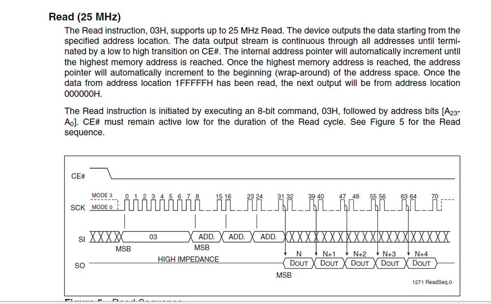

     From the SST25VF016B SPI flash datasheet, we can know the read sequence:
So, now, from your SPI bus wave, your SPI slave already give feedback as 0XAD in the data field.
You said, in the LPC code, you still get the wrong data, it is 0XFF. So now the problem mainly in the SPI code side.

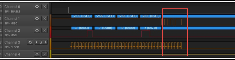

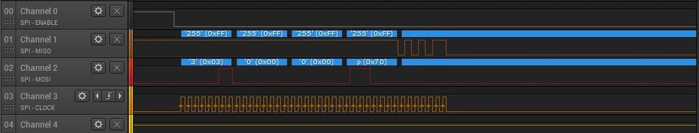

with above code the signals :
11,199 Views
kerryzhou
Hi fatih ozen,
   Thank you for your updated information and the effort.
   I find your SPI bus wave have problems:
You can find the receive byte clock just 7 bits. There should have some errors.
Do you have debugger?

When I checked the Fifo Status Register,
 Its value is 0x422. without while(!(SPI_GetStatusFlags(SPI2) & kSPI_RxNotEmptyFlag)).
 Its value is 0x10462 with while(!(SPI_GetStatusFlags(SPI2) & kSPI_RxNotEmptyFlag)).
According to table there is seen RXERR, TXNOTFULL, RXNOTEMPTY with your suggested code.
When I clear tx/rx errors and empty FIFOs before writing process, nothing changed.

I did as you said, and the results :
FIFOSTAT shows two different results: 0x420 and 0x10460.

    I modify your E_Flash_Read_Byte function like this, you can try it:
int16_t E_Flash_Read_Byte_kerry(uint32_t ui32Address){
uint8_t i=0;
for(i=0;i<8;i++)
     Testbuff[i]=0;
SPI2->FIFOCFG |= SPI_FIFOCFG_EMPTYTX_MASK | SPI_FIFOCFG_EMPTYRX_MASK;
//Double check it, make sure the buffer is empty, you also can add a break point here, to check the RXNOTEMPTY bit in FIFOSTAT register.
while(SPI_GetStatusFlags(SPI2) & kSPI_TxNotFullFlag)
     dummyTest = SPI_ReadData(SPI2);//Put breakpoint here, if it really won't enter, this while code can be delete.
SPI2->FIFOSTAT |= SPI_FIFOSTAT_TXERR_MASK | SPI_FIFOSTAT_RXERR_MASK;
//Send Byte1
if (SPI_GetStatusFlags(SPI2) & kSPI_TxNotFullFlag)
     SPI_WriteData(SPI2, READ, 0);
//Send Byte2
     SPI_WriteData(SPI2, ((ui32Address >> 16) & 0xff), 0);
//Send Byte3
     SPI_WriteData(SPI2, ((ui32Address >> 8) & 0xff), 0);
//Send Byte4
     SPI_WriteData(SPI2, (ui32Address & 0xff), 0);
//Send Byte5
     SPI_WriteData(SPI2, DUMMY_BYTE, kSPI_FrameAssert);
/* wait if TX FIFO of previous transfer is not empty */
 while (!(base->FIFOSTAT & SPI_FIFOSTAT_TXEMPTY_MASK)){};
 //read the bytes together
 for(i=0;i<8;i++)
        if((SPI2->FIFOSTAT) & SPI_FIFOSTAT_RXNOTEMPTY_MASK)
             Testbuff[i++] = (SPI2->FIFORD);
//then debug the code, stop here, check the TestBuff data, and i data.
//whether i=5, and Send me the TestBuff data. if TestBuff[4]= 0x60 as your SPI wave, then return this data.
return(Testbuff[5]);
{SPI_WriteData(SPI2, READ, 0);}
{dummy = SPI_ReadData(SPI2);}
{SPI_WriteData(SPI2, ((ui32Address >> 16) & 0xff), 0);}
{SPI_WriteData(SPI2, ((ui32Address >> 8) & 0xff), 0);}
{SPI_WriteData(SPI2, (ui32Address & 0xff), 0);}
{SPI_WriteData(SPI2, DUMMY_BYTE, kSPI_FrameAssert);}
{dummy20 = SPI_ReadData(SPI2);}
return(dummy20);
Please debug it, add breakpoint at :
1. line 21
   Check Register FIFOSTAT, send me the data.
2. line 62
   Check TestBuff data and i data. Send me the data or the debug screen shoot.
Don't care about your lcd and flash code at first, after we make the external flash read works, we will modify it to meet your lcd and flash code demand.
Let's keep patience and check it again on your side.
Besides, still check the SPI bus wave , and send me with this function.
Kerry

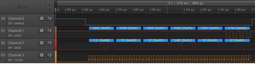

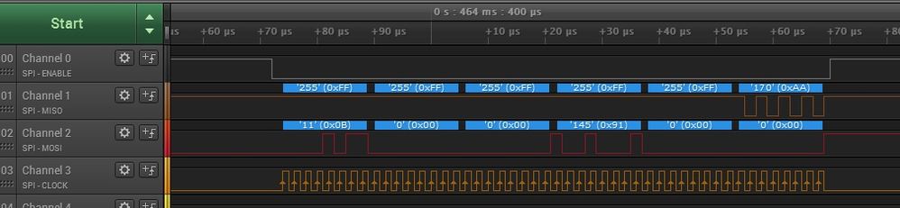

fatihozen
Well, there is news on my side.
I changed functions as you can see in attachment. There are two meaningless points:
First one is I can't see datas with Read Function but I can see them with Fast Read Function.
Second is I can't read first written data. I mean if I write only one byte I obviously see 0xff because of this problem.
Example:
E_Flash_Write_Byte(0x000091,0xaa);
E_Flash_Write_Byte(0x000092,0xbb);
E_Flash_Write_Byte(0x000093,0xcc);
E_Flash_Write_Byte(0x000094,0xdd);
E_Flash_Write_Byte(0x000095,0xee);
E_Flash_Write_Byte(0x000026,0xb3);
E_Flash_Write_Byte(0x000033,0x3b);
result=E_Flash_Read_Fast_Byte(0x000091);
result1=E_Flash_Read_Fast_Byte(0x000092);
result2=E_Flash_Read_Fast_Byte(0x000093);
result3=E_Flash_Read_Fast_Byte(0x000094);
result4=E_Flash_Read_Fast_Byte(0x000095);
result5=E_Flash_Read_Byte(0x000026);
result6=E_Flash_Read_Byte(0x000033);
After these, I see  : ff aa bb cc dd ff ff.
First written data can't be read and read byte function doesn't work here.
Any idea to solve this ?
(Everything looks good as before on scope side.Datas are seen at MISO line.)

fatihozen
You can find images and output files of recording at the attachment

kerryzhou
Hi fatih ozen,
   Thank you for your image, your image help me to recall your question, it is really a long time, I nearly a little forget the detail.
   At first, sorry for my last function code, there has a mistake, which you have remove the line 14-17.
  I copy the wrong flag, please use this code and test it again:

Line 14-17 should check SPI_FIFOSTAT_RXNOTEMPTY_MASK, not TX, just like my comment.
Please use API test this picture:
Please also follow your own orginal test, write address 0x91 with 0XAA data, then read it, but just use my API to read it.
Then give me all the TestBuff[0-7] data, and the according SPI bus wave.
Your problem really in the read function, so use my code, and give me your debug result when you read the address 0X91 which already have the 0XAA data.

fatihozen
Hi Kerry Zhou,
at line 10 FIFOSTAT = 0x30.
while block between lines 14-17 doesn't cause a problem so I did not delete it.
I added some dummy write because you wrote 'READ_FAST' there. The result is :pastedImage_3.jpg
 TestBuff[0] = 0xff,
 TestBuff[1] = 0xff,
 TestBuff[2]  = 0xff,
 TestBuff[3]  = 0xff,
 TestBuff[4]  = 0xff,
 TestBuff[5]  = 0,
 TestBuff[6]  = 0,
 TestBuff[7]  = 0.
When I modify your function for normal speed read, I see that result:
TestBuff is the same.
