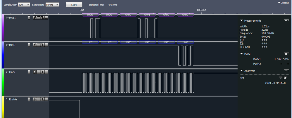

It took some time because of cleaning unuseful datas for you, you can find the project and circuit in attachment.
Im using MCUXpresso. ( MCUXpresso IDE v10.1.1 [Build 606] [2018-01-02] ).

I found half of problem. The data comes earlier than I expect. Still not working properly.

Datas on logic analyzer still the same as previous pictures.

    My demo board is LPC54608J512, it is 180 pin, so I can't use your code directly, so I use the SPI9 instead of your SPI2.
   My pin is:
   SPI_CS  :  P3_30, J9_15 on LPCXpresso 54608
   SPI_MISO:P3_22, J9_11 on LPCXpresso 54608
  SPI_MOSI:P3_21, J9_13 on LPCXpresso 54608
   SPI_CLK:P3_20,  J9_9  on LPCXpresso 54608

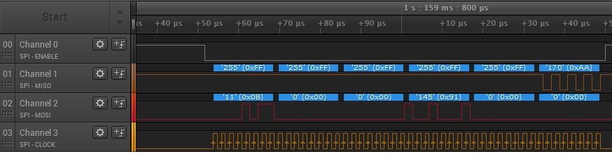

  My SST25VF016B MISO can't output the data, maybe my SST25 board have the problem, because I don't have the according board for SST25, I just sold it in my another board, mybe that board still have problem to this external chip.
  So, I test your FastRead_91.JPG on my LPC54608 directly, two lpc54608, one is master, used to send the 91 data(0X0B, 0X00, 0X00,0X91,0X00,0X00), another board used as the slave, send out:0XFF,0XFF,0XFF,0XFF,0XFF,0XAA
This is my test result:
This is the debug result with SDK code in master:
So, you can find, when master send out 0X0B, 0X00, 0X00,0X91,0X00,0X00, it can get the correct data:

I test it based on spi_polling_b2b transfter project.
At least, when the SPI bus wave is correct, the SDK code can get the correct MISO data.

fatihozen
Sorry, I am too late,
I could not see any data at first and then I deleted 14-17 lines.
I checked fifostat at line 21 and its value is 0x30.
at line 62  TestBuff[5] is 0,
TestBuff[6] was 0xff.  and fifostat at line 62 is 0x32. sometimes 0x30 but mostly 0x32.
And it looks correct on the bus.
