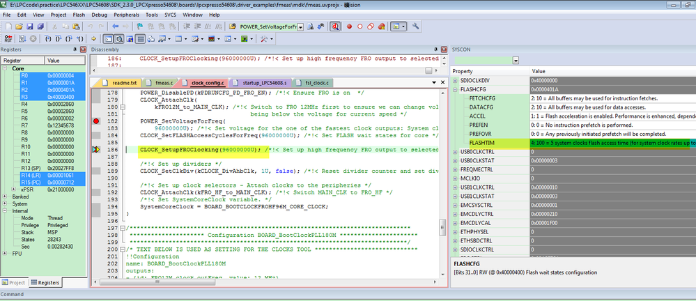

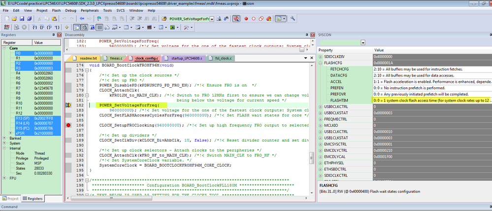

    I have test POWER_SetVoltageForFreq with frequency 96000000Hz. the FLASHCFG[FLASHTIM] is changed , it works.
   I think you didn't add this code:
    POWER_SetVoltageForFreq(
        96000000U); /*!< Set voltage for the one of the fastest clock outputs: System clock output */
    CLOCK_SetFLASHAccessCyclesForFreq(96000000U); /*!< Set FLASH wait states for core */

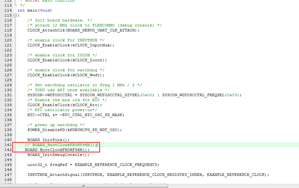

  I also use the SDK code, the project:SDK_2.3.0_LPCXpresso54608\boards\lpcxpresso54608\driver_examples\fmeas\mdk
Then do this modification:
Then test the 96M function.
I think you didn't add  CLOCK_SetFLASHAccessCyclesForFreq(96000000U);///*!< Set FLASH wait states for core */
Please follow my step, then try it again.
