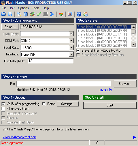

I have LPC54608's Evaluation Board(OM13092). I want to program it via my custom programmer and I use Flash Magic. My custom board is simple. There is USB to UART serial converter.
I am connecting related pins on my custom programmer with Eval board's related pins. ( There are P4 header on board and GND, TX ( P0_30_ISP_FC0_TXD), RX (P0_29_ISP_FC0_RXD) pins on it.
I connected my Eval boards RX to Custom boards TX, other TX to RX and GND to GND.
I could program it succesfully. But later I could not. Could anybody tell me what should I do to program my board ?

   Well, I have found the solution if this is described as a problem for other nxp community members. While powering the board I held the ISP_0 switch pressed. When it is powered I left ISP_0 switch. From ISP>Read Device Singature Menu, I checked the enabling ISP mode is ok or not. When it is in ISP mode I see datas about my board. If it is not connected there is no info.
   Thanks to NXP.
