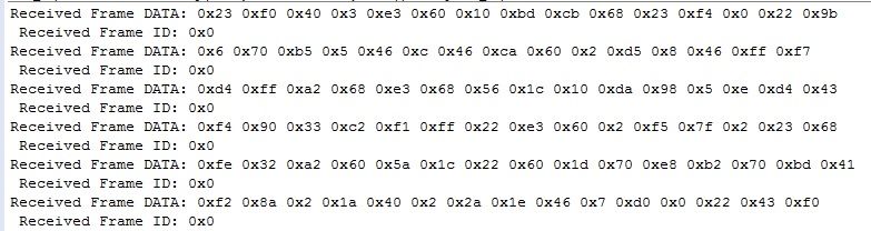

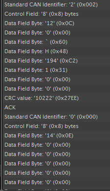

fatihozen
Okay then I move with can loopback example in SDK. But could not achieve the goal. I just want to see datas in my side.
My init code is below.
I know datas coming in 8 byte mode with 500kHz and has normal id. other nodes ids 0x000 and 0x002. I expect to see datas in picture 1 but I see datas like in picture 2. and datas in 2nd picture is meanless. There are 15 bytes ? and I see
that datas are coming even if I dont connect wires to bus. I know that's all are basic infos but I get stuck.

while (1)
PRINTF("\n Received Frame ID: 0x%x\r\n", rxFrame.id);
PRINTF("Received Frame DATA: ");
while(rxFrame.dlc--)
PRINTF("0x%x ", *(rxFrame.data++));

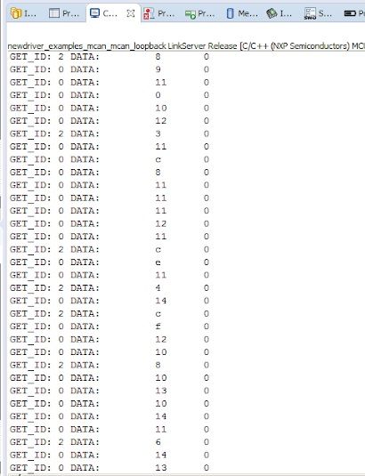

Hi jeremyzhou,
I did sth but now have a new problem, I see some datas, receiving datas in fifo0 but I don't know how to see them in buffer.
These are datas I want to see but don't know how to use them. For example I want to use switch case structure according to first data but I don't know how. Could you help me ?

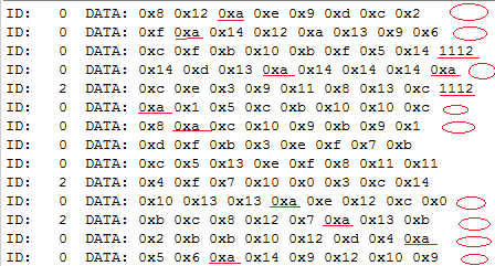

fatihozen
Hi jeremyzhou‌,
I know my questions are simple but I'm trying to achieve the goal. According to code below I wait to see some output if any byte in frame is 0xa. But I am missing something I don't know.
while(!rxComplete)
PRINTF("ID: %3x", rxFrame.id >> 18);
PRINTF(" DATA: ");
count = 9U;
while(--count)
while(++count < 9U)
rxFrame.data--;
if(rxFrame.data[0] == 0xa)
{PRINTF("1112");}
if(rxFrame.data[1] == 0xa)
{PRINTF("1113");}
if(rxFrame.data[2] == 0xa)
{PRINTF("1114");}
if(rxFrame.data[3] == 0xa)
{PRINTF("1115");}
if(rxFrame.data[4] == 0xa)
{PRINTF("1116");}
if(rxFrame.data[5] == 0xa)
{PRINTF("1117");}
if(rxFrame.data[6] == 0xa)
{PRINTF("1118");}
if(rxFrame.data[7] == 0xa)
{PRINTF("1119");}
PRINTF("\r\n");
According to this output I did or understand something wrong. Could you tell me what is the missing point ?
13,101 Views
jeremyzhou
Hi fatih ozen,
Thanks for your reply.
Giving a try the following code.
while(!rxComplete)
{PRINTF("1112");}
{PRINTF("1113");}
{PRINTF("1114");}
{PRINTF("1115");}
{PRINTF("1116");}
{PRINTF("1117");}
{PRINTF("1118");}
{PRINTF("1119");}
PRINTF("\r\n");
PRINTF(" DATA: ");
count = 9U;
while(--count)
TIC
13,101 Views
fatihozen
Hi jeremyzhou‌,
I know what datas I should see on my side on canbus. There is a problem again. When I use semihost console datas have expected values. In second byte(column) I must see all zeros.But if I use UART console I see there some non-zero values. What does cause this ?
13,113 Views
fatihozen
It is okay now. I defined new array and matched it with rxFrame.data. It is working now.
for(int a=0;a<8;a++) {mydata[a] = rxFrame.data[a];}
Code is below for someone stucks here. Thanks jeremyzhou‌
