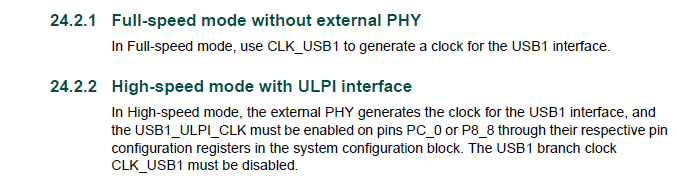

kerryzhou
Hi Kevin,
1. LPC54608 ULPI
   Please refer to this LPC546XX USB training document:
17_LPC546xx USB.pdf
You can find this information:

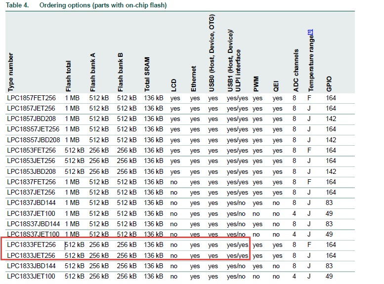

2. LPC1833 ULPI
  The LPC1833 ULPI interface support info is in the following table:
Now answer your several questions about the LPC1833 ULPI:

Please take care, in LPC18xx series, USB0 support the high speed PHY, you don't need to connect external PHY, but USB1 in high speed, it need to use the ULPI connect with the external high speed PHY.
