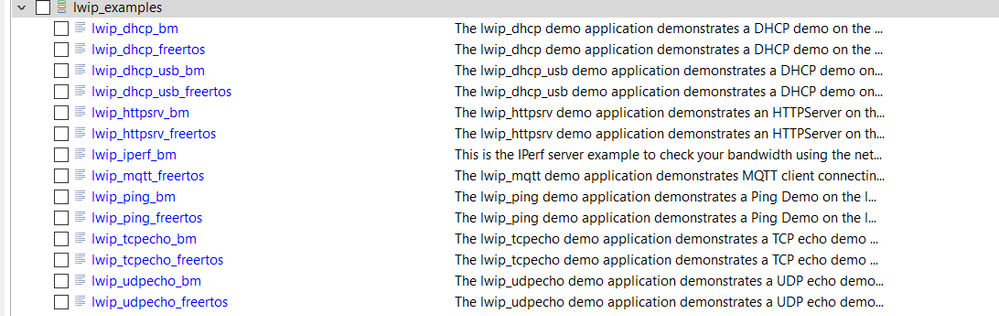

Good morning,
I ask help to you for development an update firmware through Ethernet. How I can do ?
I should implement UDP protocol ? There are some example code ? Any idea for made this..
Your help would be appreciated.
Thanks a lot
Marco
4,671 Views
Hello Marco Pazzi ,
You can refer to the Ethernet demo under SDK, then add some flash erase, flash program APIs refer to your bootloader
requirement.

mpazzi
Hi ALice,
thanks for your help.
I've already implemted tcp-modbus server using demo code.
Now I need to implement a bootloader from ethernet, I see that the link used is based on UDP server, but I don't know extactly how to implement that. I ask NXP help with some example usefull.
What you mean " ....then add some flash erase...." or " ...flash program APIs...", it sound like more or less.

mpazzi
Hi Martin,
thanks for your reply. I take a look about you suggest, but it look like different for LPC54606, and different from UDP example for LPC54608 demo board.
Actually I'm trying to implement the TFTP protocol based over UDP, but is not so easy.
Do you have any suggestion or idea ??
