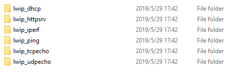

xiangjun_rong
Hi, Rene,
As you know that the LPC family supports LWIP ethernet stack, you can download the SDK package from the link:
Welcome | MCUXpresso SDK Builder
In the SDK package, there are Ethernet examples as following.
Pls download the package and have a try.
