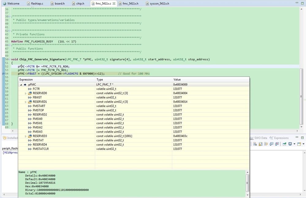

chrispflieger
It seems to get stuck waiting on the status. The output registers are all zero.
 * @brief Signature register block structure
typedef struct {                    /*!< Signature Structure */
    __IO uint32_t FCTR;             /*!< Offset: 0x000 Control register */
    __I  uint32_t RESERVED0[3];
    __IO uint32_t FBWST;            /*!< Offset: 0x010 Wait state register */
    __I  uint32_t RESERVED1[3];
    __IO uint32_t FMSTART;          /*!< Offset: 0x020 Signature start address register */
    __IO uint32_t FMSTOP;           /*!< Offset: 0x024 Signature stop address registers */
    __I  uint32_t RESERVED2;
    __I  uint32_t FMSW0;            /*!< Offset: 0x02C Word 0 of 128-bit signature word */
    __I  uint32_t FMSW1;            /*!< Offset: 0x030 Word 1 of 128-bit signature word */
    __I  uint32_t FMSW2;            /*!< Offset: 0x034 Word 2 of 128-bit signature word */
    __I  uint32_t FMSW3;            /*!< Offset: 0x038 Word 3 of 128-bit signature word */
    __I  uint32_t RESERVED3[1001];
    __O  uint32_t FMSTAT;           /*!< Offset: 0xFE0 FIFO Status register */
    __I  uint32_t RESERVED4;
    __O  uint32_t FMSTATCLR;        /*!< Offset: 0xFE8 FIFO Trigger level register @cond */
} LPC_FMC_T;
 * @brief FMC control register bits
#define FMC_FCTR_FS_RD0             (0x01 << 3)
#define FMC_FCTR_FS_RD1             (0x01 << 4)
 * @brief FMC status register bits
#define FMC_FMSTAT_SIG_DONE         (0x01 << 2)
void Chip_FMC_Generate_Signature(LPC_FMC_T *pFMC, uint32_t signature[4], uint32_t start_address, uint32_t stop_address)
    pFMC->FMSTART = (start_address / 16) & 0xFFFF;
    pFMC->FMSTOP = (stop_address / 16) & 0xFFFF;
    pFMC->FMSTATCLR = FMC_FMSTAT_SIG_DONE;
    pFMC->FCTR &= ~FMC_FCTR_FS_RD0;
    pFMC->FCTR |= FMC_FCTR_FS_RD1;
    pFMC->FMSTOP |= 0x00010000;
    pFMC->FBWST = 5;        // Good for 100 MHz
    while (0 == (pFMC->FMSTAT & FMC_FMSTAT_SIG_DONE));
    signature[0] = pFMC->FMSW0;
    signature[1] = pFMC->FMSW1;
    signature[2] = pFMC->FMSW2;
    signature[3] = pFMC->FMSW3;
8,094 Views

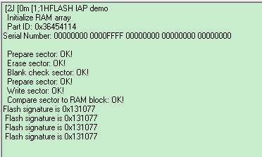

jeremyzhou
Hi Chris Pflieger,
Thanks for your reply.
I've ported the fmc_5411x.c and fmc_5411.h in the perph_flashiap demo in the LPCOpen library, and run this demo on the LPCXpresso54114 board, it works well.
I've attached the demo, please give a try.
Fig 1
