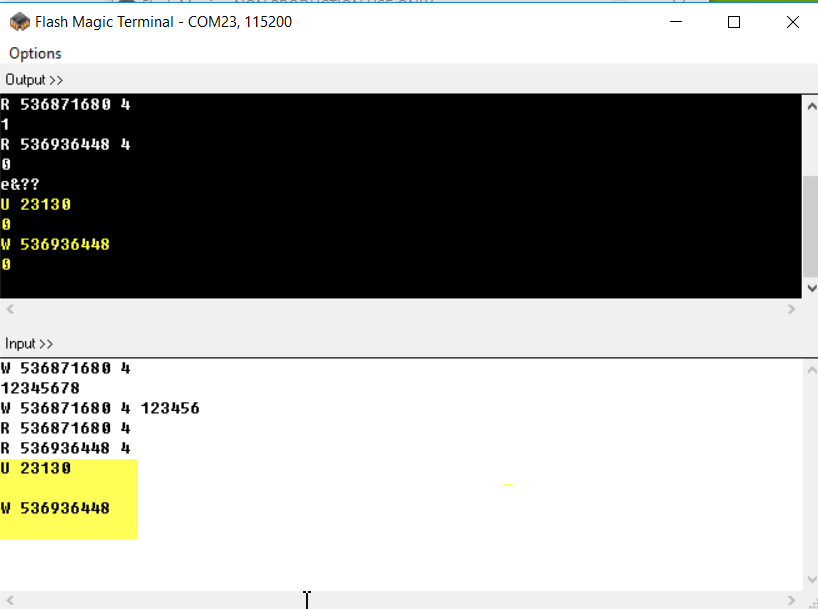

Hello Senthil,
I use the  Flash Magic Terminal to test,  the "U" and "W" commands can work well:
It can communicate well with Real term terminal  on PC, meaning there is no problem in LPC54114,

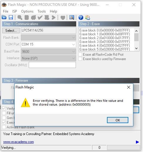

seku
Hi Alice,
Thanks for the reply.
I have downloaded the flash magic and programmed my hex file. The programming is done but the verification is getting failed. Not sure what is the reason. Attached the screen shot for reference and also my hex file.
Senthil

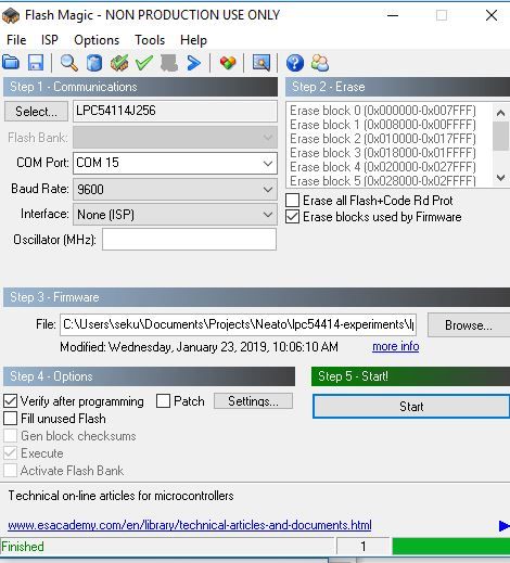

seku
Hi Alice,
I have chosen the Erase blocks used by firmware option. Now I did over cover the verifying error. The programming has been finished. However after reset, the code is not executing, the LED is not glowing in RED.
My code is just glowing the LED in RED (P_0_29)
Senthil
