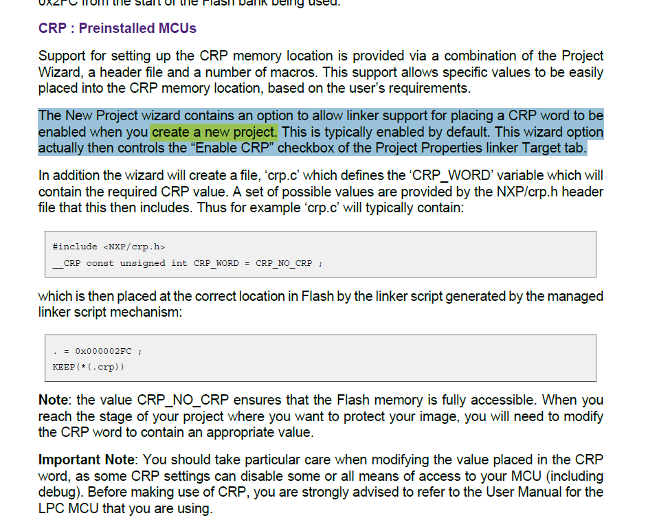

Reading the User guide, it appeard that I can disable the ISP modes using the CRP register location in Flash.  Reading through the documents here https://www.nxp.com/docs/en/user-guide/MCUXpresso_IDE_User_Guide.pdf  Page 119, it sounds like the following code can instruct the linker to load in this setting to Flash:
__CRP const unsigned int CRP_WORD = CRP_NO_CRP ;‍
The doc also refers to a gui setting in the "linker tab" which I have been unable to find.  I did find the code snippet in my startup_lpc5411x.c file.  So I edited that file to:

   From the MCUXpresso IDE user manual, we can get:

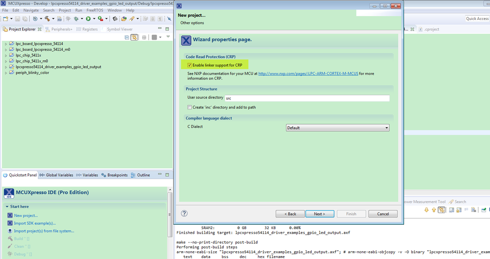

The new project create Wizard have the CRP options:
You can refer to this post:
How to create a new LPC project using LPCOpen and MCUXpresso IDE

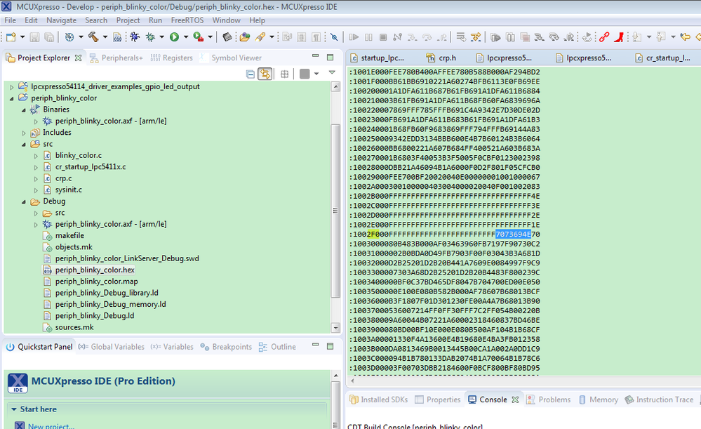

Then build the project again, you can find the .hex file, address 0x2fc already be changed to the CRP_NO_ISP data:
#define CRP_NO_ISP    0x4E697370

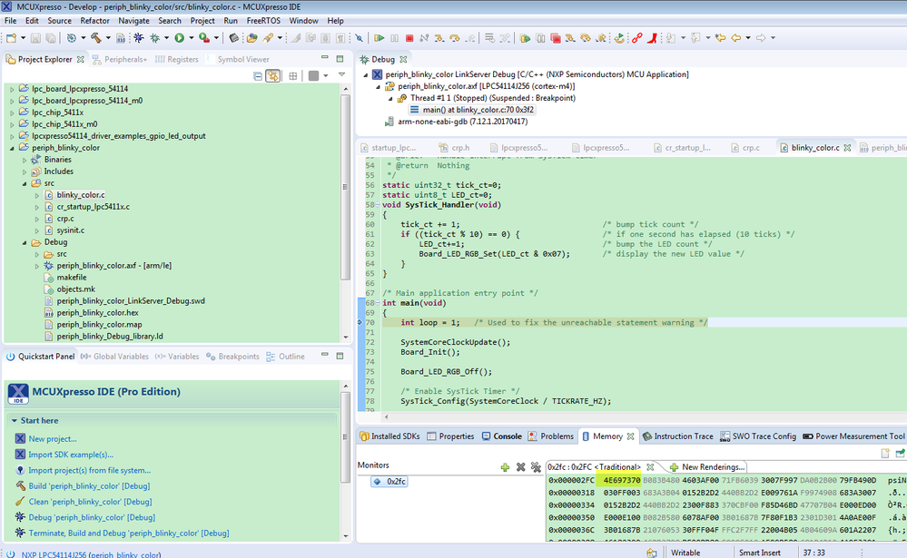

Then debug the code, check the memory:
The CRP data really be changed.
You can't make it work, you can check your hex file, whether 0X2FC have changed to 0x4E697370.
Just modify the data, and don't do the configuration in the IDE, won't realize the CRP modified function.
