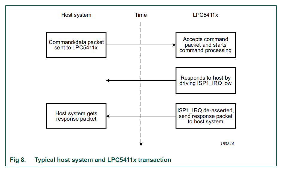

FelipeGarcia
Hi Senthil,
The LPC will respond correctly to the host if the host is sending the appropriate commands to the LPC54114.
Please check image below for the process.
Also, please make sure that you are configuring the SPI correctly on the host side:
SPI Config:
   -Clock should not exceed 2 MHz.
   -SPI SSEL to first clock timing should not be less than 100 us.
   -SPI transfer configuration should be SPI Mode 0 with 8 data bits.

9,032 Views
FelipeGarcia
Hi Senthil,
Please accept my apologies for my late reply. Could you please try sending the probe command first? Please check UM chapter 4.8.5.
This command is required to select I2C or SPI interface when booting from a reset condition.
Please check flowchart below:
Hope it helps!
Felipe

FelipeGarcia
Hi Senthil,
Yes, the MCU will respond to the Host command by driving ISP1_IRQ low. Please have in mind the following note from the user manual.
Note: SPI transactions are bi-directional. During the command packet phase, the host
system should ignore the read data (send data from LPC5411x). During the response
phase, the LPC5411x will ignore the read data (send data from host).
Felipe
