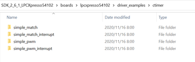

I am currently working on trying to get an 2 PWM output signals with different frequency with the LPC54102.
The SCT right now is able to output one signal, but I am trying to do the same with the CB32Tx peripheral. I couldn't get around any example codes on how to do it, I was wondering if you guys have any material I could use???? is this application achievable????
thanks,
Ricardo B.

xiangjun_rong
Pls download SDK package from the website for LPC54102-EVK:
https://mcuxpresso.nxp.com/en/welcome
 and refer to PWM example based on CTimer.
Hope it is helpful
